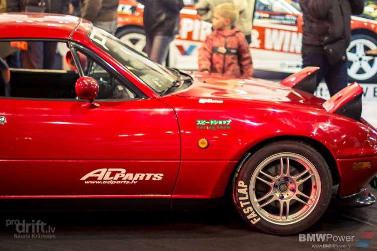

Īss ieskats :roll:
'94 Eunos Roadster (Mazda MX5) 1.8
Exterior
OEM Hard top
GV front lip (PU replica :oops: )

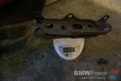

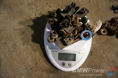

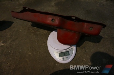

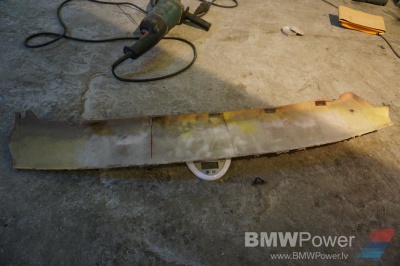

Excess weight removed (no bumper beams, no baby teeth, etc)
Modified rear bumper
TRS tow straps
Custom reg. plate mount
Reinforcements
Cusco Safety 21 roll bar
P5 Sportdrive frame rails
Suspension

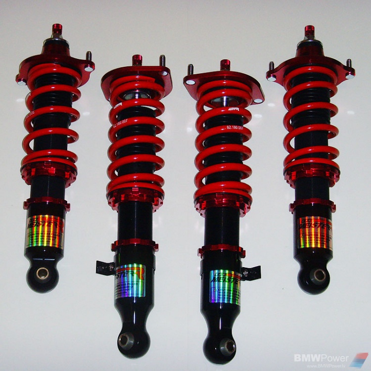

Meister R Zeta-S coilovers F: 7 kg/mm R: 6 kg/mm
Drivetrain
1.5 way clutch-type LSD
4.3 final drive
Engine
IL Motorsport engine mounts
MSPNPv2 ECU
Innovate LM1 wideband
Racing Beat 4-1 exhaust manifold + Coolrace 1600gr/m2 wrap
Custom 2.5" exhaust with Magnaflow & Kalkis Motorsport mufflers
Brakes
Axxis ULT pads
Custom cooling ducts
Motul RBF660
Wheels
Toyo R888 195/50-15 on 15x7 Kosei K1 TS
Kumho KU31 195/50-15 on 15x7 ATS 5-star

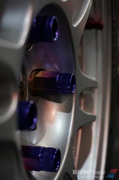

VMS lightweight wheel nuts
Interior

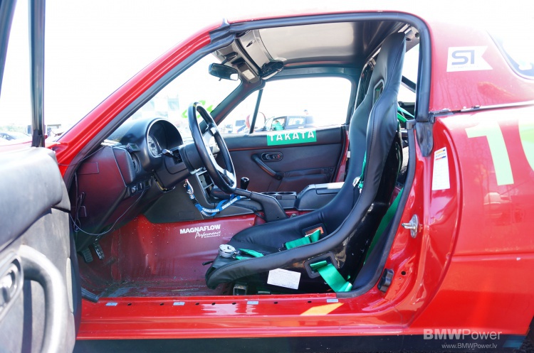

Nardi steering wheel
One-off ebony wood shifter knob
Cobra Aerorace seat
Takata 6-point harness (īsta :31: )
Custom harness bar (AML)
Excess weight removed (no audio, no carpet, various bits removed, modified wiring)
PerformanceBox GPS lap timer / datalogger

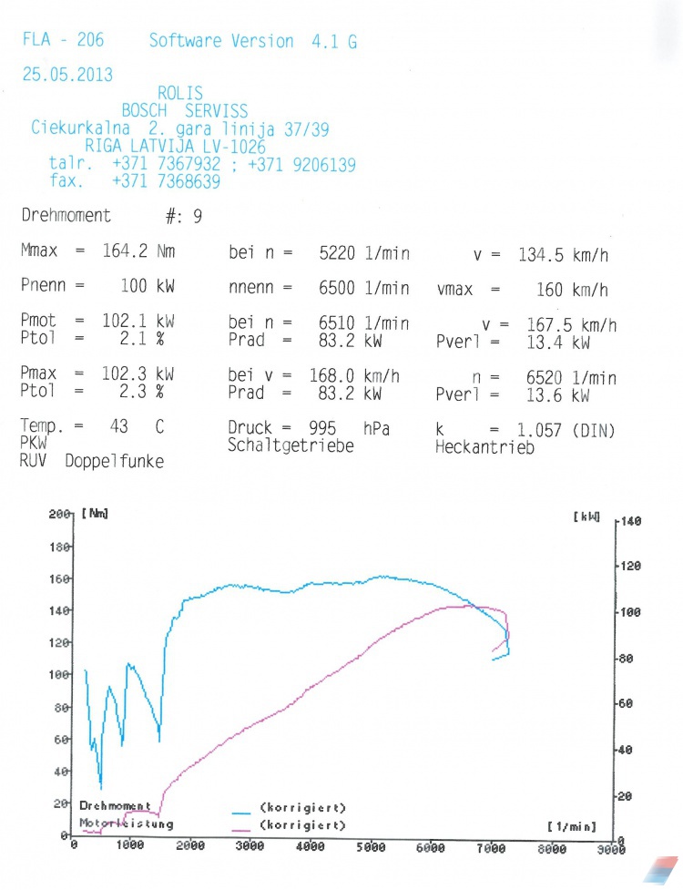

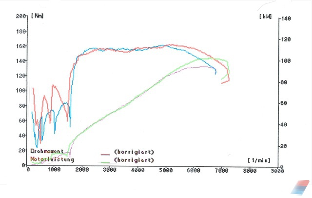

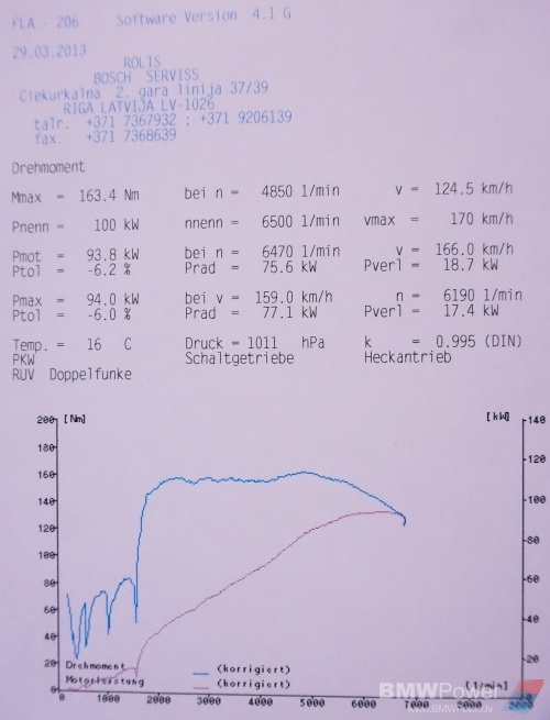

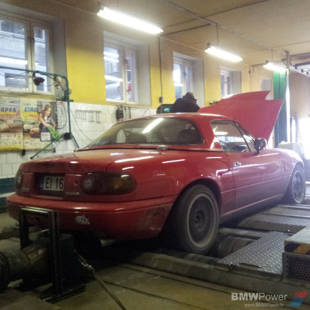

Uz Bosch Rolis ruļļiem:
standarts: 163 Nm / 128 zs; tagad: 164 Nm / 139 zs
Svārs ap 950 kg.

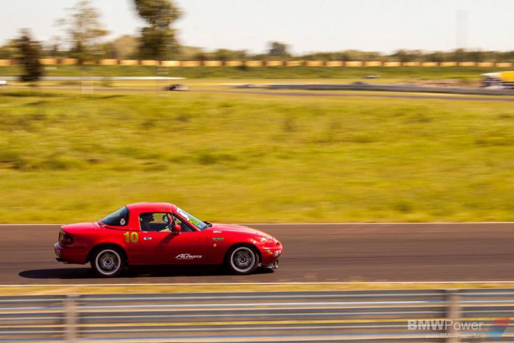

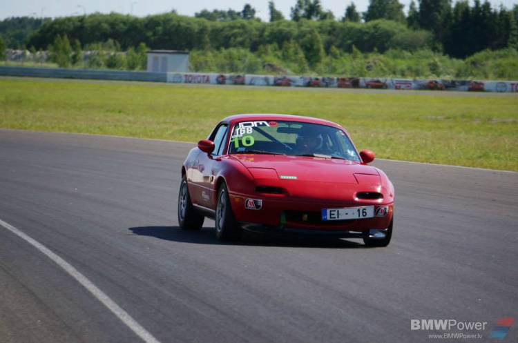

Apļa laiki:
333: 0:59.9
Audru Ring: 1:37.999
Biķernieki auto (peļķes): 1:47.5
Biķernieki automoto (bez roteriem): 3:00.2
Biķernieki automoto (ar roteriem): 3:02.6

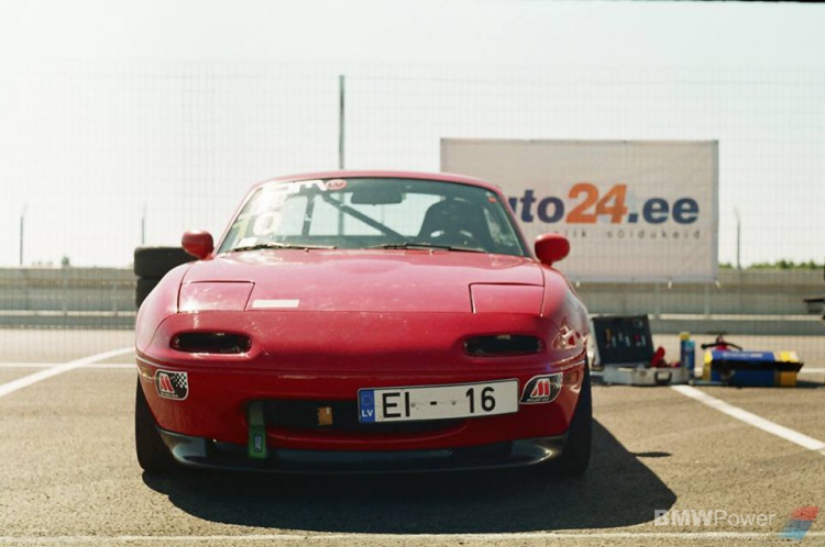

Pāris jaunākas bildes
Attēls
Attēls

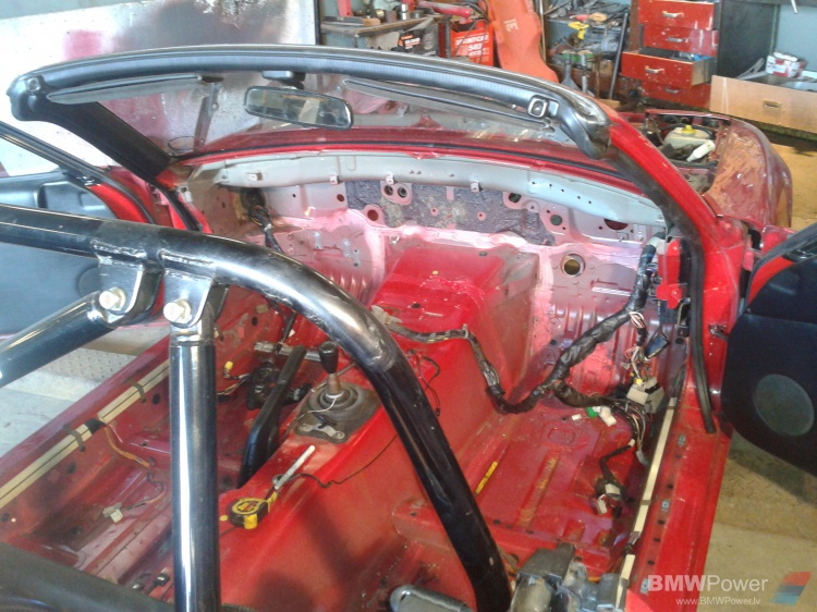

Beidzot saņemos uzlikt vēl pavasarī nopirktos P5 Sportdrive frame rails - sliedes, kas pastiprina lonžeronus un palielina virsbūves cietību.
Attēls
Attēls
Atšķirība milzīga, tagad daudz vairāk svārstību aiziet uz atsperēm, kur amīši tiek ar tām galā. Must have piekares apgreids uz MX5.
